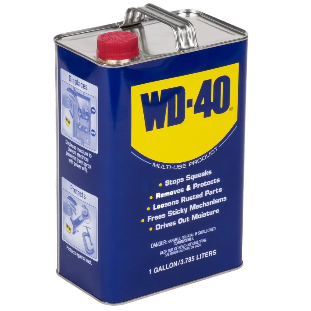

You may want to consider getting a bottle (not spray can) of WD40 to flush the box out with since its primary function is to displace water from parts.
See: https://www.amazon.com/WD-40-Multi-Use- ... RGKSW7P27S
