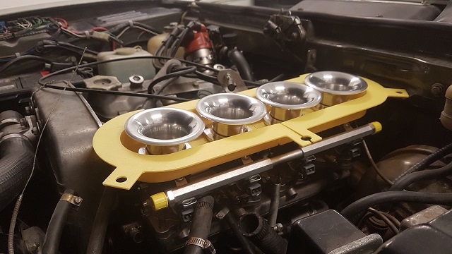

So, trial fited the jenveys. They fit and match the manifold perfectly. Had to shorten then connector for the butterflies between the bodies because they are so close together but no big deal. I will have to make a new bracket for the throttle cable as it will not work with the jenveys. Had to se what it looked like with the airhorns on. yummy....

I got the 40mm "IDF style" throttle bodies (part # TFP40i). Since I have a 1600 motor I figured 40mm should be plenty large. They are also available in 42 and 45 as well so should be no problem matching whatever output you're aiming for. I got these because they are a direct replacement for the stock weber IDFs. Therefor I can reuse the stock manifold. I couldn't find much info about this kind of conversion for the twin cam engines so my work so far i all based on educated guesses
Also ordered air horns (AH40X40), 330cc pico injectors (IN47/330), fuel rail (TBR32), regulator (WFR024, RH01) and TPS (TP1) from jenvey.

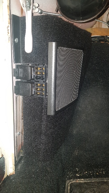

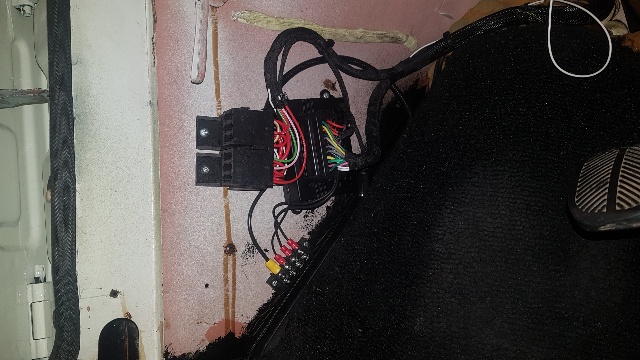

Started wiring everything. The microsquirt and new fuses/relays are located in the driver side behind a speaker box the previous owner installed.
Driver side of the engine bay is all wired up. Everything but the wideband controller and the future ignition coil is on the driver side. MAP sensor and vacuum log is mounted on the side/under the intake manifold.

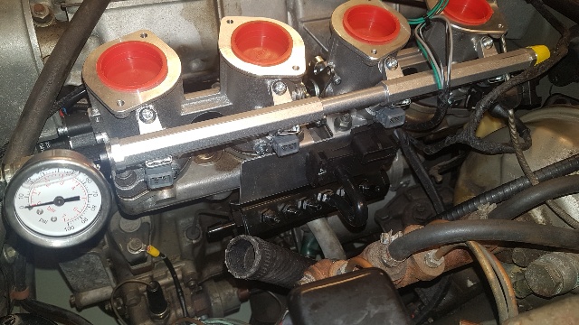

No. I am taking vacuum from every runner on the jenveys. These are run to the vacuum log which i visible in one of the pictures above. From there I will take vacuum for the brake booster, MAP sensor, and fuel pressure regulator. I will take a picture of it for the next update.aj81spider wrote:Are you deleting the vacuum assist on the brakes?
Yes, there is a TPS as well! I'm using this one from jenvey:grrrdot wrote:Are you running a TPS as well? If so which TPS did you end up going with?
https://store.jenvey.co.uk/throttle-bod ... n-cp17-tp1
When I get everything up and running we will see if I can run fueling on speed density with MAP-reading or if I will need ITB mode which combines MAP at low loads and TPS at high loads.

The Microsquirt is up and running
I got good readings from all sensors and I got RPM input from my coil. Injectors are fireing as well so almost done for a test start!
I am waiting for a high pressure pump but it will probably not arrive until next week. I was also planning to put an O2-sensor in the stock exhaust but I tried getting the downpipe out of the car but the pipes are rusted together solid... Thinking I might replace the whole exhaust but it is an expense I wasn't planning for until later.
/C
