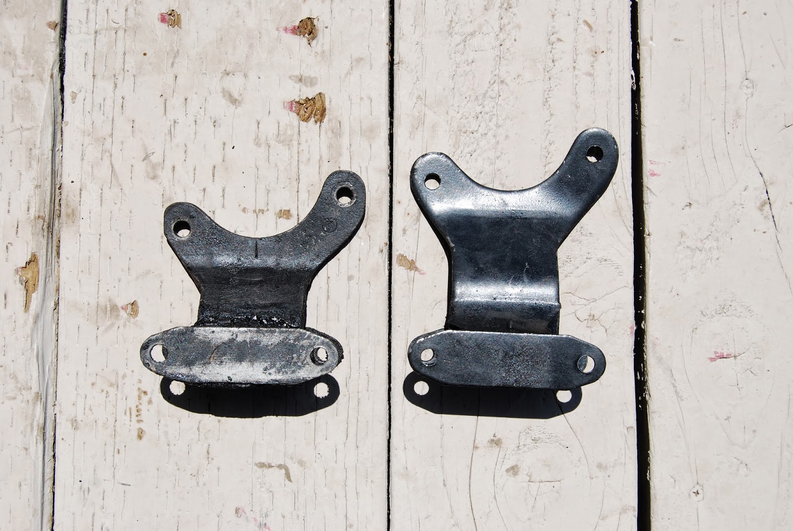

Just an FYI.
I picked up one of these mounts from AR for my 71 124 Coupe and it too was almost a full inch taller than the one I removed.
I mocked up the install the floor jack to check clearances in the trans tunnel with the tail about 1 inch higher.
All looked good. I installed the new taller mount and the noise from my trans was totally gone on the test drive thereafter.
Looks like Ramzi and Csaba once again have done their homework.

Just on the subject of the mount though, currently I have a 'short' mount and to me it looks like a 'tall' mount might push the gearbox up against the body, but vendors claim that tall mounts can replace short mounts. As posted above even for the same size mount, there options with harder and softer rubber. Does anyone have any good or bad experiences with the tall/short mounts and/or firmness of rubber?
As suggested, the first step will be a new transmission mount and if that doesn't cure most of the vibrations, slowly we will have to eliminate any of of the other possible causes.

I can't help with the firmness question, but I did manage to purchase the wrong mount for my '71 spider and it didn't quite fit. It was taller, which was OK, but the bolt holes where it attached to the transmission weren't in the right place. So, yes, it did fit, but I had to drill extra bolt holes.nemoo wrote:Does anyone have any good or bad experiences with the tall/short mounts and/or firmness of rubber?
Overall, I wasn't very happy with the solution, but I just didn't want to deal with returning the part, getting a refund, and finding the correct mount. I honestly don't recall which vendor it was, but it was one of the "major" vendors (either AR, M-B, or Vicks).

Thanks for the info! I think I will buy one of the shorter ones then.18Fiatsandcounting wrote:I can't help with the firmness question, but I did manage to purchase the wrong mount for my '71 spider and it didn't quite fit. It was taller, which was OK, but the bolt holes where it attached to the transmission weren't in the right place. So, yes, it did fit, but I had to drill extra bolt holes.nemoo wrote:Does anyone have any good or bad experiences with the tall/short mounts and/or firmness of rubber?

V12StealthHunter wrote:I bought one of these from AR for my 71 Spider;
http://www.autoricambi.us/product/MO7-4 ... 5-5-speed/
But it appears to be at least 3/4" taller than the old one (after compensating for the deteriorated rubber). Here is a link to a photograph of my mount next to the AR mount.
http://4.bp.blogspot.com/-zP3lPRp89iI/U ... C_0001.JPG
I initially thought their 4-speed mount looked like a better match. But I think I'm wrong after looking at it more.
I noticed that both Vicks and Midwest list a "5-speed" mount that looks like a closer match to mine;
http://www.midwest-bayless.com/storefro ... =313990215
http://www.vickauto.com/newstore/index. ... ts_id=2929
If I use the taller mount I think the shifter extension will interfere with the transmission tunnel. The one Vick's lists looks right to me. Anyone know whats going on here with all these different mounts listed for the same application?
