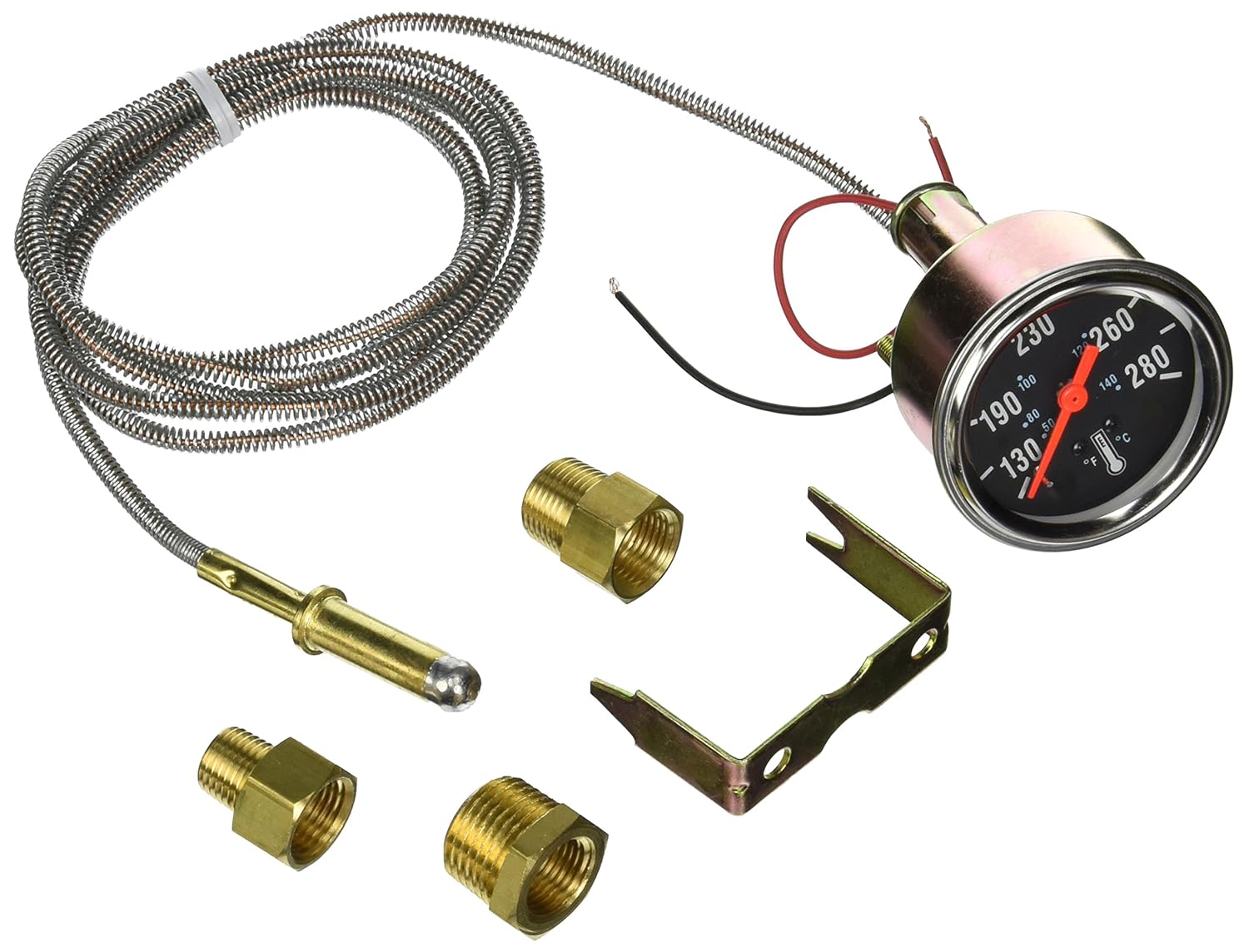

What is the reading where the sensor is bolted on? It is possible that there is a 20 degree variation between the head and the fitting where the sensors are mounted.
Any chance that the system could need to be burped a bit better or that it needs a good white vinegar flush to get rid of some hard water scale built up over the years?
I know I am guilty of skipped a flush and stretching things longer than the standard 2 years but re-mediate with a good complete flush using a 50/50 mix of distilled water and white vinegar before refilling with new coolant and since I live in Semi-Tropical Florida I use a Water Wetter type agent to enhance thermal transfer. I have been using the Lucas product lately and though I was skeptical at first it does make a noticeable difference in reducing extreme temperature swings.
I have a SUN Capillary Tube temperature gauge which eliminates electrical gremlins from the equation. You could put one on temporarily using the same location for the probe and see if the readings are different.
Mine is similar to this one from Dorman:
