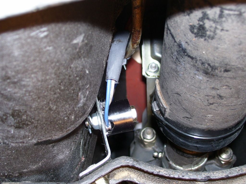

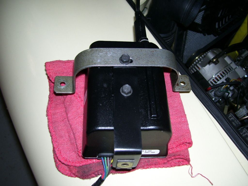

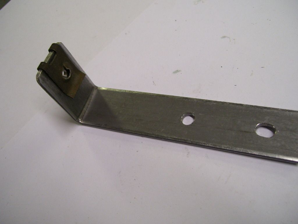

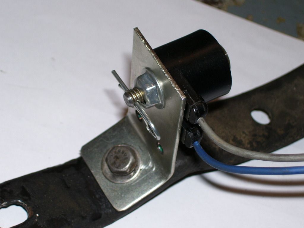

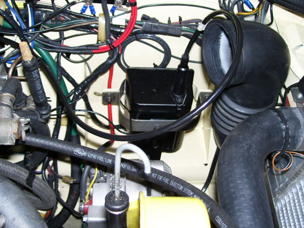

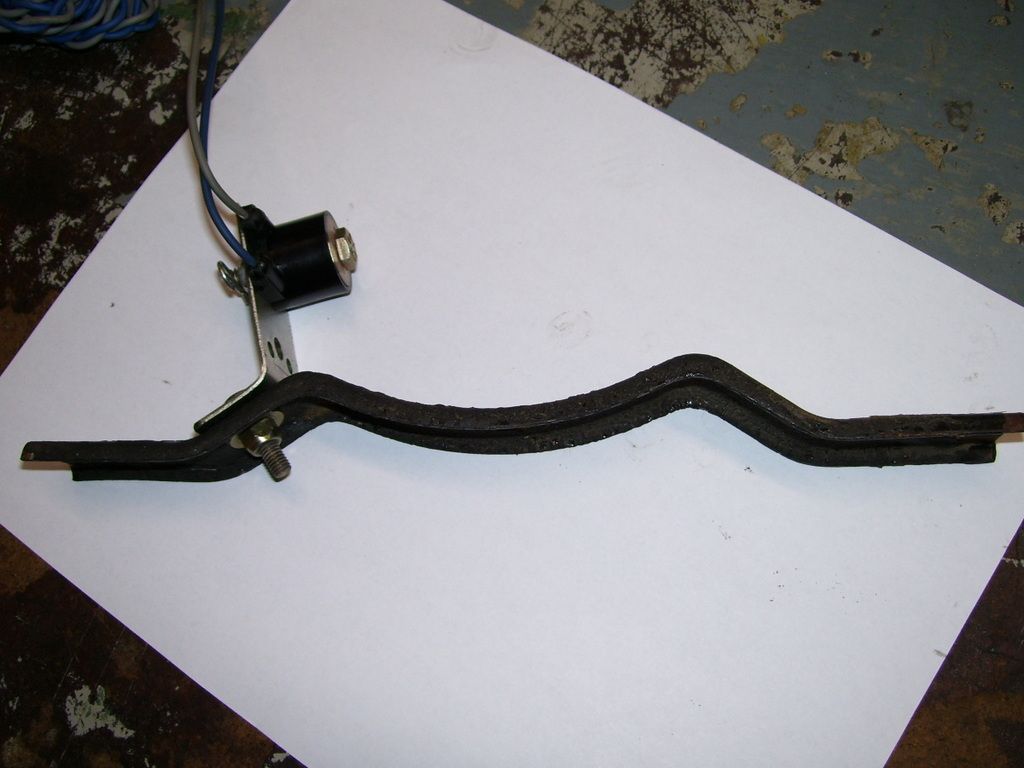

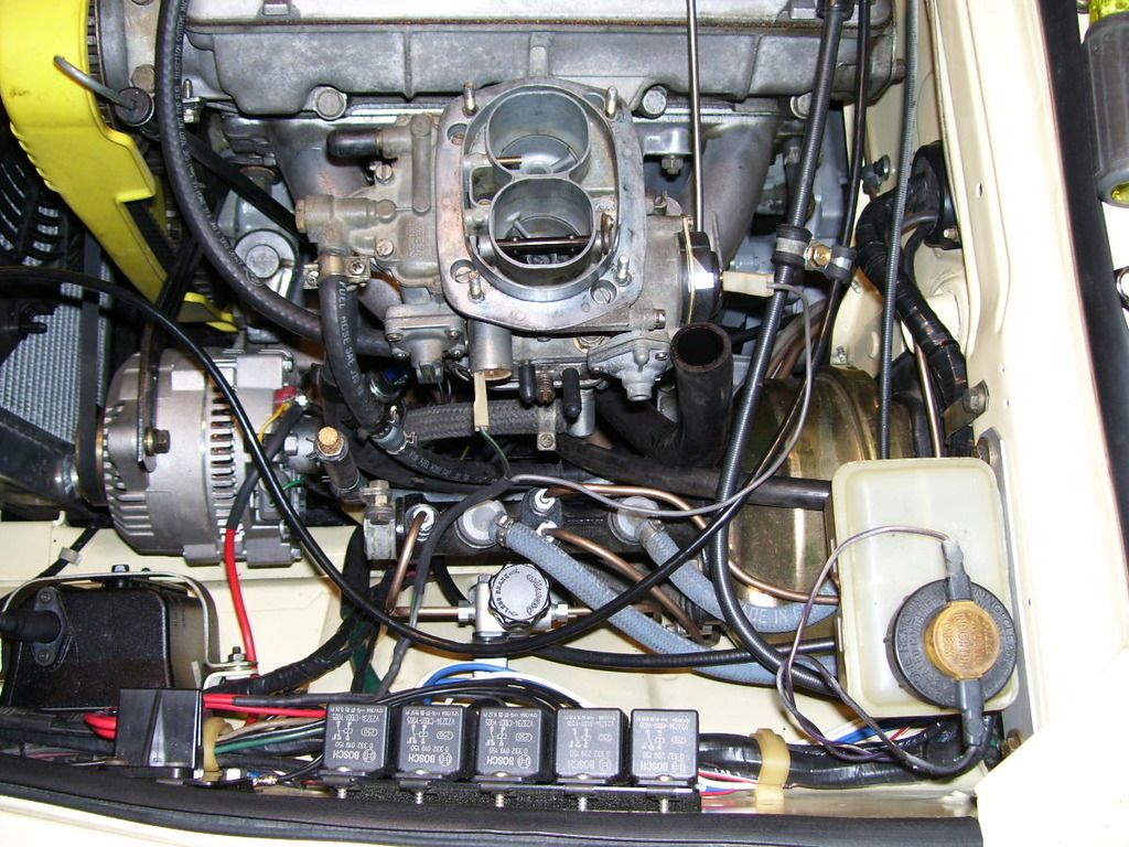

I mounted the cruse control actuator where the charcoal canister was located and made a L-bracket that attaches to the existing strap, the actuator and bolts to the fender well.
