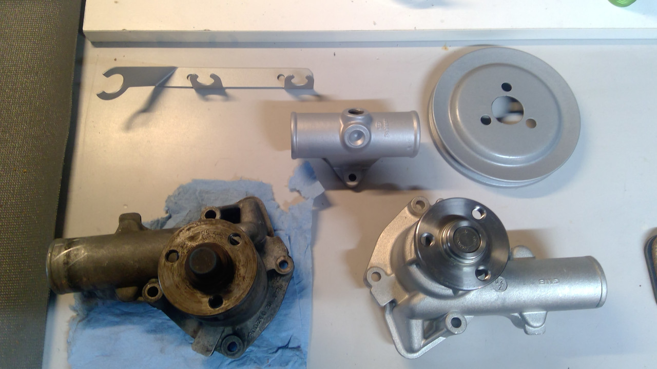

Hey all,
Started the water pump replacement, fluid drained, parts are off, and some are even cleaned and painted. Accomplished the removal without breaking any bolts or creating any new swear words. Cleaned and sanded all mating points and getting ready to put things back in place. I have read as many threads as I can handle on replacing the water pump and gaskets but all this reading has still left me a little uncertain if a sealer should be used on the pump and heater pipe gaskets and how to re-fill the cooling water. So...I'm sure ill get some different opinions but hoping to get a majority vote on the sealer and just an fyi all mating points look good and straight... so maybe no sealer even needed? When removing the cooling water I only drained the rad, removed the lower rad hose, removed the "T" and caught what poured out when removing the pump...never touched the engine block just mentioning this incase it effects the re-fill procedure. Thanks for any help...cheers!
Some pictures for fun.
