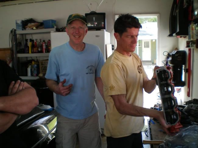

We had a good time today. Five guys showed up including Mark who brought over some parts that were needed and stayed around to offer advice. He did a very commendable job not laughing at us novices. The work crew included Gary Pogue (you may remember he was interviewed on TV last year when the wildfires got right up to his house) Ryan (SpiderHead), Alvon (Ventura Ace), and me to help Steve get his engine ready to install. We ran into a couple snags that cost some time, so by 7:30 PM when I had to leave it was not quite done yet.
This first picture shows the cars that were there:
This is Ace and Gary getting a cam tower ready:
This is the whole crew torqueing the flywheel on: (We had to hold the engine and the stand to keep it from spinning)
Here's the crew (minus me, the photographer) working on the bench getting cam towers put together:
