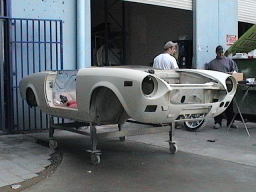

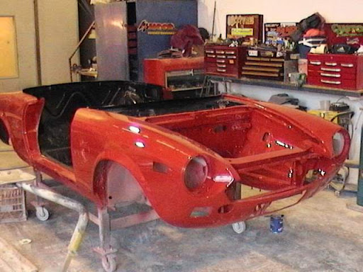

I completed the whole restoration on a chassis stand. I drilled and fitted some 10mm blind nuts where the jack points are located and mounted here. The blind nuts are fitted with a special swag tool, but I guess you can find a suitable alternate if you don't have access.
I had the car on this stand when towing on a flat bed truck. Worked a treat.

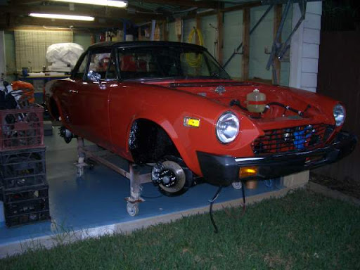

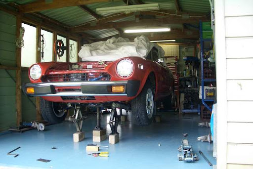

Refer photo to get the car off the stand. I suggest you use better axle stands than scissor jacks and bricks. I nearly dropped the car at one point of lowering.

The car sat about 650mm above the ground. This was a good height to work underneath. Although welding up-side-down is tricky. My wheels where rated to 250kg each and are about 100mm diameter.
The car has been on the cart during its whole restoration. I installed the engine after it was back on its wheels. As for painting, the Painters has no problem. The doors and boot lid where fitted while the car was on the stand.

I had the whole car built on the cart except for the engine and gear box with no balance issues. I did use a support for the rear axle, more to counter the droop and springs falling out than loading up the cart. I used the existing jack points. This centres the weight nicely and the car is bolted to the cart, not simply sitting on it. Balance issues will only exist if the the car is loaded outside the perimeter of the cart.azygoustoyou wrote:balanced if the cart is centered
