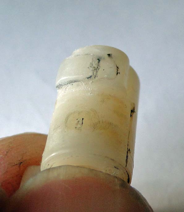

Let us know if that works. The melted cam lobe is a very common problem with the earlier Sipea ignition switches that have seen much use, and I have never found a source for a new plastic cam lobe. I have used a soldering iron to reshape the plastic so that the switch functioned a little better, but it's just an OK solution. Finding another Sipea switch with a good cam is the only thing I've been able to come up with.
I agree with Dinghyguy that if someone could 3D print these parts, there would be a market for them. I'd certainly buy some. The Fiat vendors might be interested as well.

18Fiatsandcounting wrote:I agree with Dinghyguy that if someone could 3D print these parts, there would be a market for them. I'd certainly buy some. The Fiat vendors might be interested as well.
Yep. I have looked into it . If I had a way to scan the part into a CAD program there are several companies that will 3D print it. Hey, maybe Jay Leno could help us out, tehe :D

It doesn't look great but it seems to work. I'll check when the 11 inches of snow melt.
