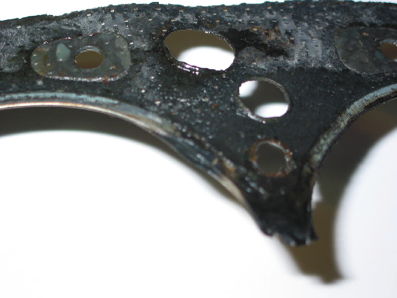

I don't know why the head gasket failed, other than the day prior I did some spirited driving. Got close to redline a "few" times but when I parked it it seemed fine. Next morning is when I noticed the problem.
Some more details
1. The gasket failed between cylinders #3 and # 4. About 3/8 of an inch wide gap was present after the head came off.
2. No Carbon build up on #4 Cylinder, the others had a lot of carbon present. What's interesting to me is that #4 plug needed cleaning fairly often with what seemed to be oil fouled. One thought I have is water got into #4 cylinder and caused the head gasket blowout, while cleaning the chamber.
3. I checked torque on all head bolts and there was no issue there.
4. No oil in the water, and no water in the oil. No metal chunks found in the oil.
Any ideas thoughts welcome..
Thanks
Dave
Some more details
Thanks
Dave

You might be on to something here as small water leaks into the combustion chamber do a good job of "steam cleaning" the head but are pretty nasty on the fire ring on the head gasket. One possible source of water is the coolant jacket on the intake manifold around the #4 cylinder. Depending on which manifold you have, some of them have a pipe at the very rear of the manifold, for the coolant circuit for the automatic choke. So, if you haven't already, check the intake manifold gasket for any issues around the #4 port.davefrancisco wrote:One thought I have is water got into #4 cylinder and caused the head gasket blowout, while cleaning the chamber.

Yea, Midwest-124 does some nice work. My brother just got the head back last week and looks better than brand new.
@Bryan - The gasket came off in pieces so hard to tell. The intake port and the visible portion of the valve have much less carbon when compared to other 3, so perhaps that where the liquid was coming from.
I also noticed what appear to be casting lines in the port. Got scared for a minute as it appeared to me as a crack, but then noticed it was in the other 3 cylinders as well.
So to conclude for now, I find the cause of the failure to be liquid entering number 4 cylinder due to failed manifold gasket.
Nut124 Thanks for asking "why"
Thanks for al the help.
Dave

Just a quick follow up on this item. When i removed the coolant intake on the head I found a thermostat. I also have the external.
I searched the forum and found that the internal thermostat is not needed, and could lead to head gasket failure. Nut124 gets credit for this find. Why would this lead to head gasket failure? Could it be higher pressure in the cooling system due to the thermostat restricting water flow? Just a guess on my side. Further explanation appreciated.
I'm asking because we concluded earlier that my head gasket failed due to water entering #4 cylinder from where the coolant controlled choke is fed from. Could the start of this failure be due to higher pressure in the cooling system which in turn caused the manifold gasket to leak water into #4 cylinder, which then led to head gasket failure?
Thanks
Dave
Thanks
Dave

Many have converted their Fiats to internal thermostats. When you do this, there must be only one hose at the T, going to the radiator. No external one. Early Fiats had an internal therm from what I have heard. Later they switched to the external therm. I assume they did it because head gasket failures due to overheating. The external thermostat always circulates coolant thru the head, even during warmup. The internal one blocks flow until at temp. With a 190F internal, this can allow localized hot spots in the head due to lack of flow, cooling.
It is not the backpressure from the internal. The pump could not generate enough pressure to hurt the head, gasket. What happens is this: When the head gets too hot, coolant pressure increases and creates higher than normal vapor pressure in the cooling system. This, along with the head perharps warping a bit due to heat, pushes the gasket fire rings into the bore, where they get crushed by the piston at TDC. This starts a coolant leak into the cylinder.
Examine your old head gasket. You might see places where the fire ring has been pinched. Like in the middle of the poor quality pic below. The piston comes up above deck at rpm and hits the gasket that has pushed into the bore. What follows is white smoke upon startup and eventual total failure.
When you get ready to install the head, inspect the head bolts carefully. Place the threads of two bolts against each other and make sure they mate perfectly. Also, thread the bolts into the block and make sure the thread goes in w/o resistance. Before torquing, install the bolts w/o the steel washer and turn the bolts until bolt head touches the head. This should require little or no torque. Do not tighten onto the aluminum. If a bolt starts to turn hard before touching the head, then either the bolt (thread) has stretched or the thread in the block is too short. This bolt will not clamp properly. The washers are about 4mm thick and this test makes sure all bolts can clamp properly even as they stretch a bit while being torqued.

Nut's analysis makes sense. The fact that you have (had) both internal and external thermostats tells me that someone has made "modifications" to this engine. Some of these may be harmless, but some could cause issues over time.
Before you put your head back on, check the flatness of both the deck of the block and the head. Also check the mating surfaces of the intake and exhaust manifolds. You can have a shop do this (maybe they already did), or you can do a reasonable job with a plate of glass and a feeler gauge. Or even a good straight edge and feeler gauge. You don't want to see more than 0.002" of warpage in any area. It's unusual for a Fiat block to warp, so you can just check that yourself rather than pull the engine just to have a shop check it.
Also, if I remember correctly, Fiat used internal thermostats in the 1438, 1592 and very early 1756 engines. All others used external thermostats. In model years, that would mean 1966 to 1970 and 1974 were internal, and all others were external.
