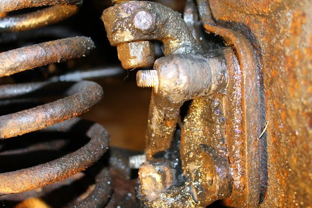

How to remove these bolts RESOLVED
The backside nuts seem to be either impossible to reach or stripped. How are these (front) removed?

Have you tried just loosening the nuts? The bolts are held in place by the plate. I have seen this before. You should be able to reach them by turning the wheel sharp right or left depending on which side. If the nuts are rusted solid you may have to cut them off and get new ones.... Just a thought....

(See above)The backside nuts seem to be either impossible to reach or stripped
Was hoping to avoid cutting, oh well

It is possible to get to the nuts, I don't remember what tool I used or if anything else in the way had to be removed. They can't be turned from the front, so if stripped beyond repair, I guess you'll be cutting.

The flat sided nuts are kept from turning by the raise lip on the sheetmetal, but they will rotate right through the lip and cause damage if the bolts are really on there! Ask me how I know this....
I had to put a BA vice grip on these nuts and restrain them from turning while loosening the bolts on the other side. Yes, rotate the steering all the way in or out and you can get at them. May take dual BA vice-grips to break 'em loose.

I seem to recall using a punch to flatten the little ridge near the flat side of the bolt head and forcing a 6 point socket on the bolt head. I also used a 6 point socket on the nut. Heat and PB blaster help a lot.

there's nuts on the backside, as you have figured out already. remove everything you need to remove in order to get to these nuts with regular socket wrench.
i haven't really bothered with these. if they won't let go, i just replace the whole hub assembly since it's the same as on lada and they're plentyfull in my part of the world

After looking on YouTube, then going to Home Depot to talk tools etc. I decided that rather than throw money, tools etc at it I would try one more time by myself to tackle these friggin bolts
Well I guess I was more determined than I thought. The reason they were not coming off is that someone had folded over the bracket on the bolts
SOB! Used a punch & chisel to correct the issue
SUCCESS
Now, how do I push the bolts through

Those bent over brackets on the nuts are called locking tabs and are bent over to prevent the nuts from coming loose and ruining you day while you are crusing down the road.

remove the hub from balljoints. hammer out the bolts. no other way to do it, it was intended to be done that way
