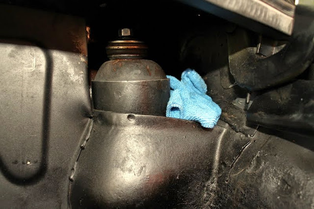

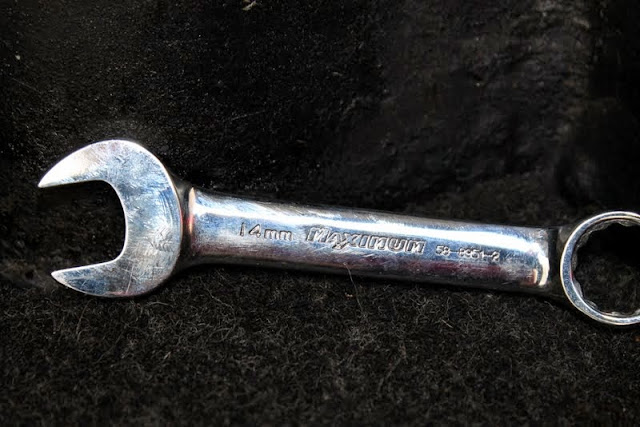

Bought Fiona some new KYB Excel - G's for the rear
Use a 14mm to loosen top nut on rear shocks
Be sure to stuff a rag in the pit of despair
Remove drivers side pan hard rod 24 mm nut
Jack up one side to lower the other
Spring and shock removed
New shock installed and spring easily seated
1 knuckle bleeder out of 10

Great pics, Jay. Makes jobs like this so much easier.

Thanks Bruce. Being a visual learner myself I thought this might help others
