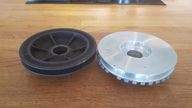

Crank trigger is the way to go, and then use your dizzy input for full sequential. You'll love it.
Make sure your crank trigger is bullet-proof! I had a homemade one at first (no idea why, my engine has an oem crank trigger out of the box) and it hit the framerail in a turn on the racetrack. The result was something like this:
Downshift
Turn in
Floor it
Hmmm feels like I lost a cylinder
Turns out the crank trigger was feeding the ecu garbage information and the megasquirt decided to just keep going. Tore a chunk out of Piston #2
It's kind of stupid but the only thing you can do when "sync loss" goes above a threshold x is turn on a check engine light. I'd love for there to be a setting that says if that happens, turn ignition off immediately, but there isn't.
