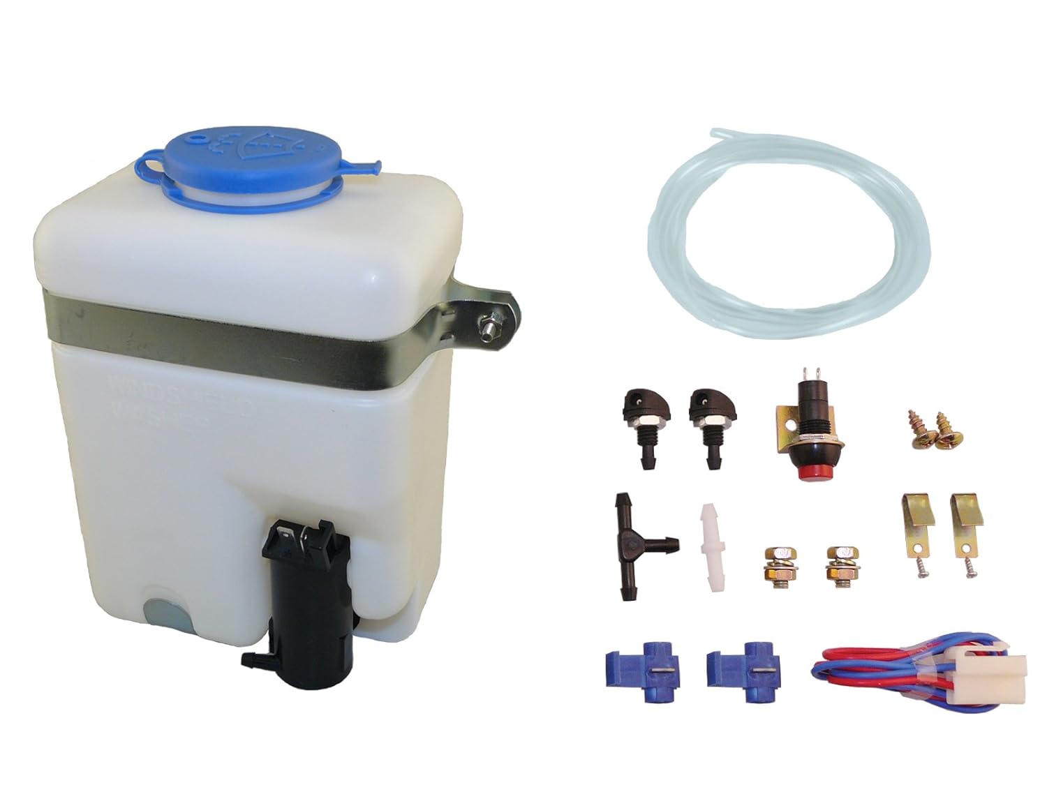

Finally got around to installing an ACI Model 99300 Universal Windshield Washer Pump Kit with Reservoir today and am pretty happy to have them operational. I had been sitting on it for some time not having a good feel for where I wanted to install the tank and just bit the bullet and put it between the remote oil filter and diesel fuel filter on the right front.
Really liked how it was a plug and play fit to the factory washer plug already under the hood requiring no modification. Only needed the white union and about a foot of tubing from the kit to install it.
The OEM nozzles that were still on the car were a pleasant surprise being adjustable up/down and left/right along with the shocker that the washer switch circuit was in operating condition and didn't require any remediation.
