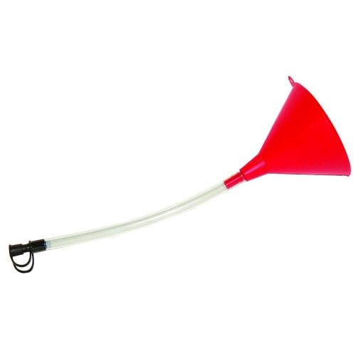

Changing the transmission oil in my 5 speed manual was a straight forward job but it came with the usual Fiat challenge. Step one was to take out the fill plug which is on the passenger side of the transmission housing. Make sure that you can take this plug out before draining the transmission or you won't be able to re-fill it. The plug is the same size as the differential and oil drain and fill plugs -- 17mm -- which makes things simple. Taking this plug out was for me the most challenging part of the job .. that sucker was on very tight and there isn't much room to maneuver up there. Once the fill plug is out then you can drain the fluid -- that was step two. I let mine drain overnight as the oil is heavy and takes awhile to empty. There is also a small square screw plug at the upper/rear of the transmission that needs to be taken out and this will drain off several additional ounces of oil. Once the transmission is drained I was ready for Step three -- refilling -- which is the reverse process. To re-fill the tranny I used a funnel with 5 feet of clear tubing. This is a picture of the one I bought at a local auto parts store but I had to buy a longer piece of clear tubing to run from the engine compartment down to the fill hole. Be sure the tube fits into the fill hole completely.
I then simply poured in the transmission oil (1.75 quarts). This took a while so I ended up securing the funnel and did a few other jobs around the garage while the new oil flowed.
I've probably given more direction than is needed or even wanted and likely a veteran will point out my mistakes.

James - I wish I'd had your tutorial before I changed my tranny fluid. The long hose and funnel trick was a whole lot better than the rather messy route I took!!
