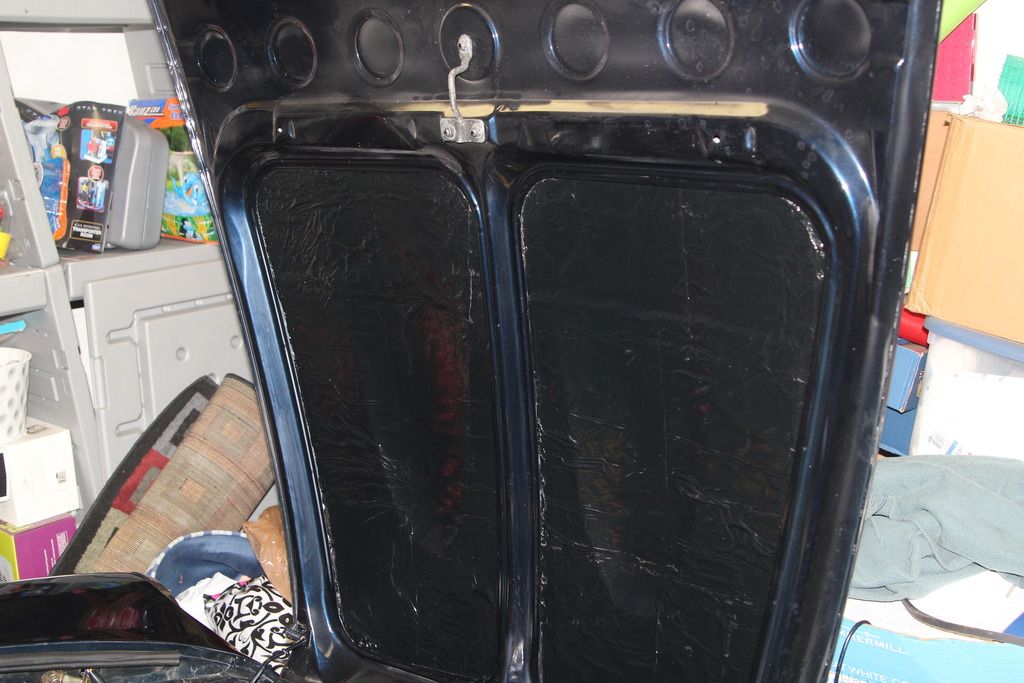

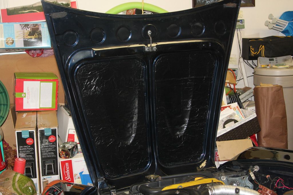

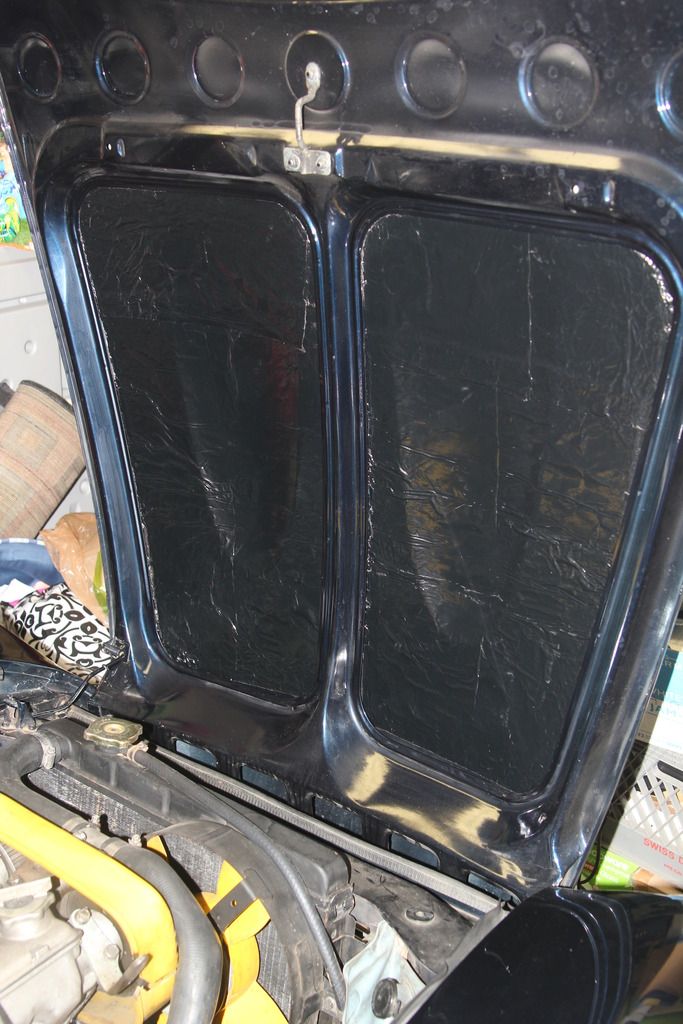

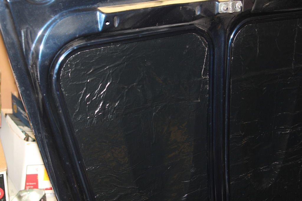

Re: Hushmat
I did the install a few day's ago and have put several hundred miles on the car with it. It is black and a bit shiny. Some of the pictures make it look silver, but it isn't, that's just reflection.
The install is easy to do, but very difficult to get "perfect". You have to sort of stick it on in the middle, and then use a razor/box cutter to get it to the exact size, and then sort of cram it under the seam.
Observations:
1) It makes the car quieter
2) It makes the hood heavier ( a few pounds) and makes the hood sound very "solid" when closing
3) It does keep the outside of the hood cooler- considerably. This is the reason I got it - to reduce the temp on the hood. But, there is still heat
4) My car seems to run about 5 degrees hotter and doesn't have as much temperature variability (that is the needled doesn't drop below 190 as far as it used to. This might be a good things (definitely in colder climates) but I'm interested to see what happens to the temp on a really hot day. (That is, will the fan be running more often) It's been very mild here.
5) I have significant left over "scraps". I'm thinking about adding a a second layer over the exhaust manifold where the hood gets hottest, and wondering if I can use some on the transmission to quiet it down a bit.
6) I had no problem getting it to contour with my small bubble hood
7) I did this solo, and I'm really bad with wrapping presents and getting things cut properly and looking nice. Figure it will only look better if you have some skill in this department.
So far - I like it - but don't expect you'll be able to put it on and have a "smooth as glass" installation. By it's very nature is has some wrinkles in it. It looks very functional, not glamorous.
