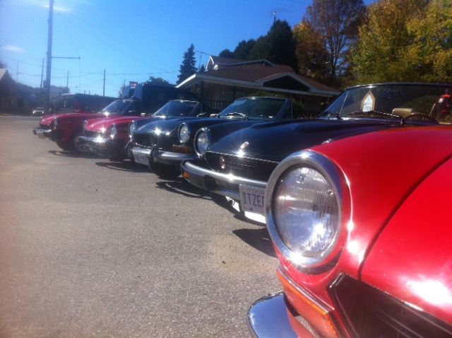

Re: headlamp chrome bezell gap
certainly seems to show the difference between the earlier car in the foreground and the USA spec blue car.
maybe unpopular opinion, but I like the recessed light in that pic better than the foreground light. I'm going to have to check mine out...
