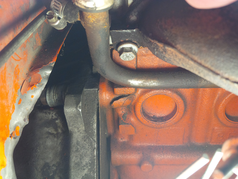

Some people just should not be allowed to go near a car with a wrench. I already found my oil drain plug stripped and with evidence of a vice grip and now this. I thought I was home free after getting the top drivers side transmission to block bolt out but the passenger side is proving even harder. It looks like someone may have stripped and tapped this and cracked the block in the process. I'm not sure of the bolt size. It something between a 19 mm and a 3/4" with about a dozen washers on it.
And I can't get it out. I'm trying the extensions technique like I did on the other side (without much luck) and I'm trying an offset wrench from above. You can see how I flattened out the lip on the firewall to get the wrench on straighter. Can't get it to budge.

Re: My late mid-life crisis 77 Spider
Uh Oh.... Not sure what to offer to solve this. Pull the engine and transmission as a unit?
