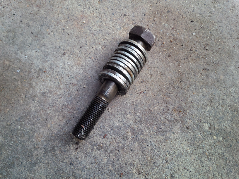

Haven't given up trying to crack that bolt yet. I love HF. I go to the one in Worcester. I've developed a tool fetish and am tempted to buy some kind of engine lift. My New England thrift side says to park it under a tree limb and rig up a winch.

Just had to man up and give this a yank. You have to believe it will crack off.

Motor mounts in place?
It looks like the wrong bolt was used, not anything to do with the threads, thus the washers to fool it into thinking it is a short bolt.

Exactly right. I think maybe they didn't use enough washers and that's why the block cracked.

The crack looks on the outside of the thread channel and doesn't leak any oil?

Nope. Hasn't leaked and looks like the bolt still has plenty of solid metal to thread into. I'll find the correct bolt for reassembly without all those washers. Current issue is wobbling that trans off the block. There's about an inch or less gap. I've got a jack on the shallow, back part of the oil pan and the trans is supported. Trying not to let it hang on the shaft in any way. Wondering how long that shaft is.

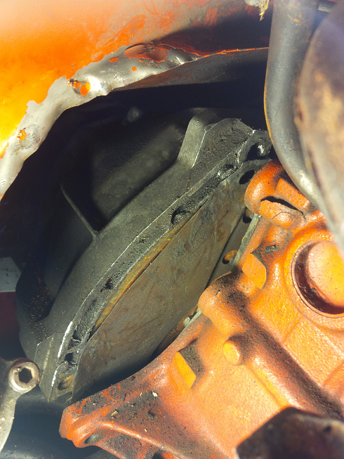

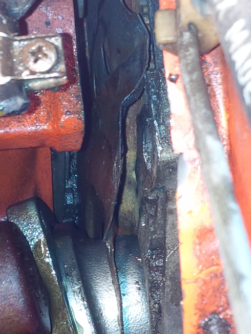

Thanks, that was a good tip to jack the front engine. The gap was wider at the top. I must be close, no?
Passenger side
Top drivers side
But it wont F'in come off!

I'm stuck. I've heard other people having trouble at this point separating the transmission from the motor but never any descriptions of what methods are used to make it happen. The inch or so I've gotten is by prying and shaking with a big screwdriver and a crowbar. I'm trying with jacks to keep the two what I think is aligned. This is a splined shaft in a splined hole I imagine. Bigger crowbar? More brute force? Any advice from experience would be greatly appreciated.

Haven't done this myself, but it is probably an alignment issue?

Maybe so. How does one know? I've got the trans about an inch away from the motor. It would be way cool if someone could tell me if I'm close.
